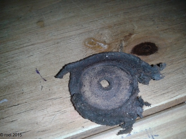

Like i said, the seal wasn`t all that great. It looked suspiciously like the seal from the that i have worked on in 2015.
On the piston it looked a bit better.
