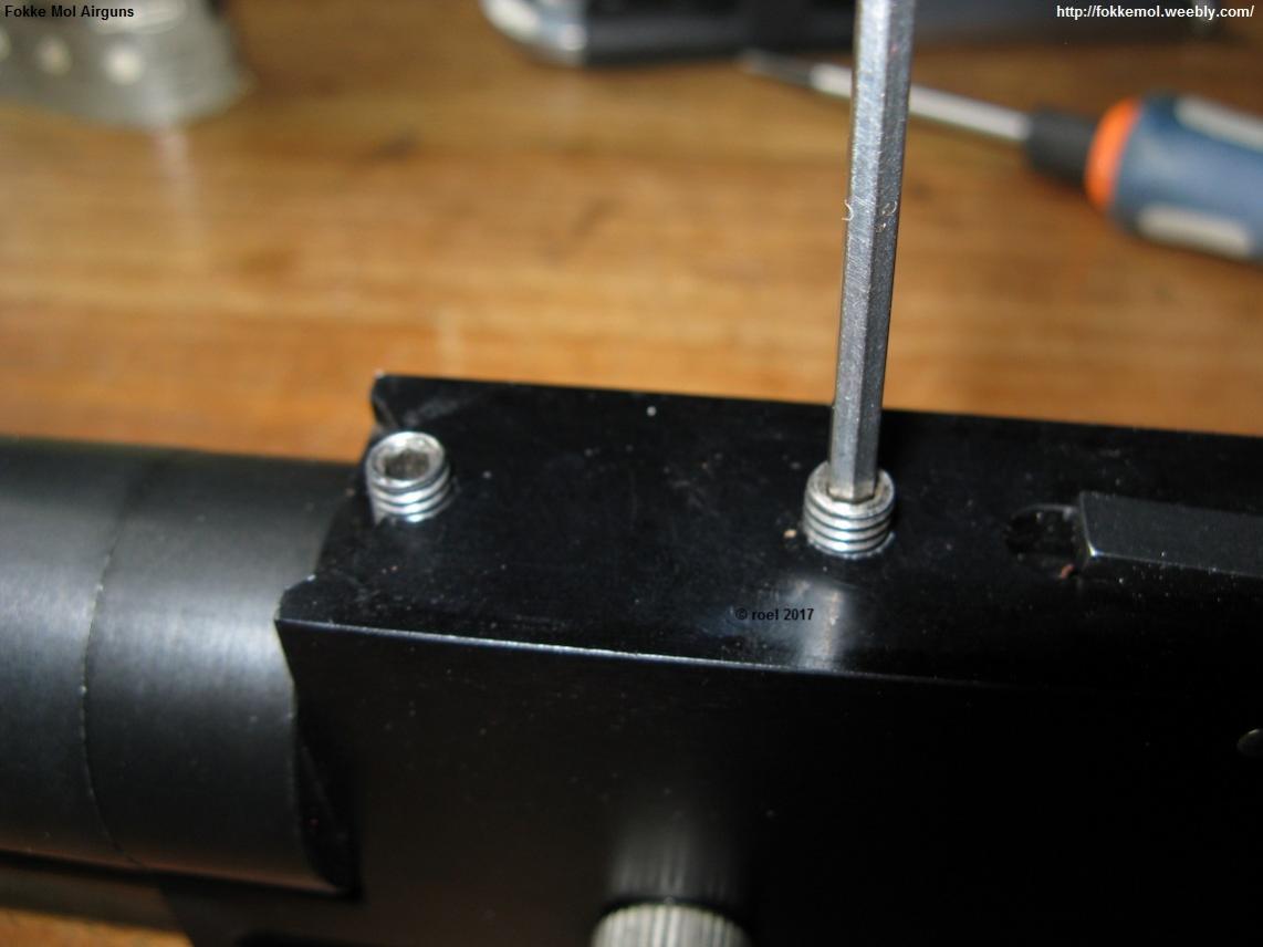

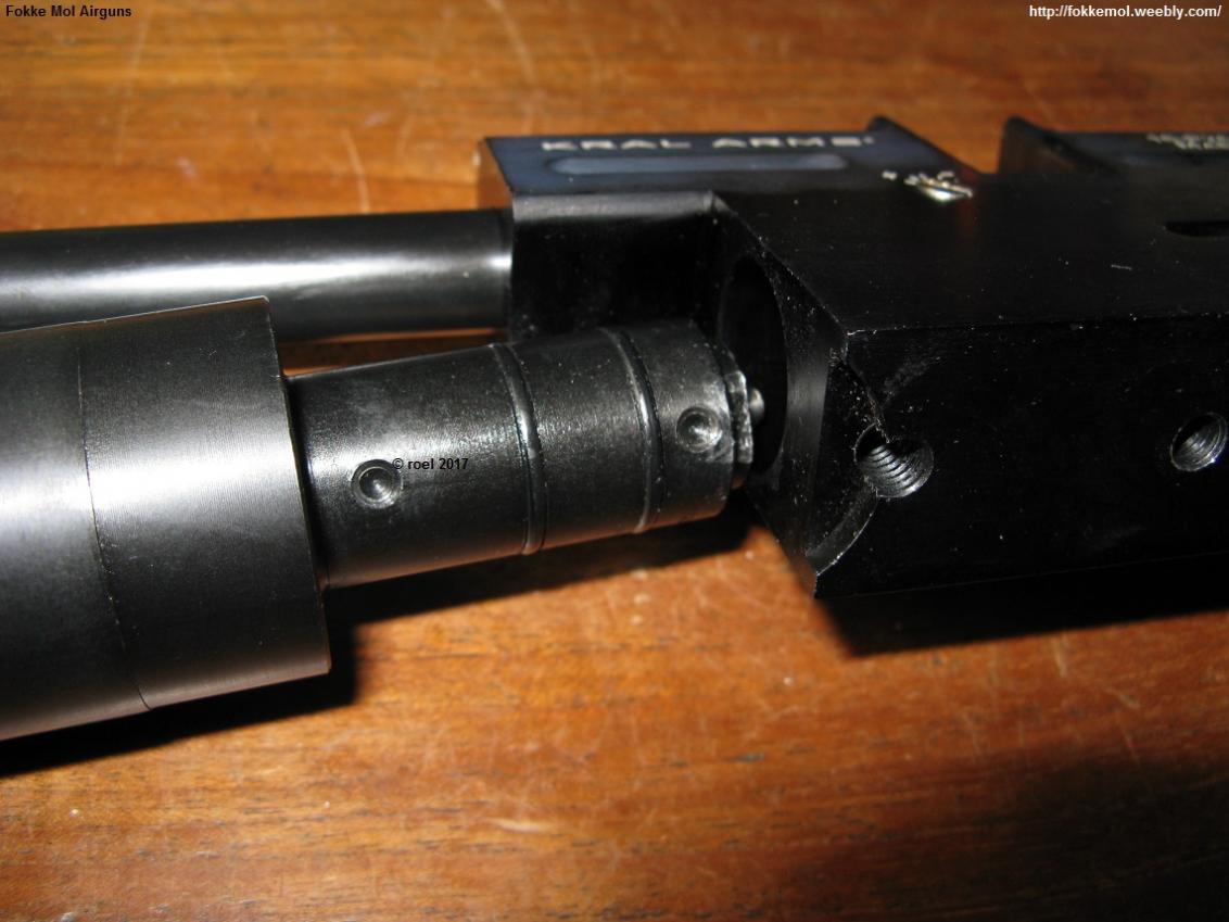

I`m taking the gun apart. First thing to do is taking the fill pipe off of the action. You don`t need to take the pressure off of it. Removing two Allen screws is enuff.
ID:	170   Click image for larger version
