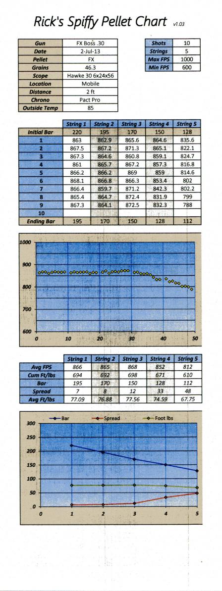

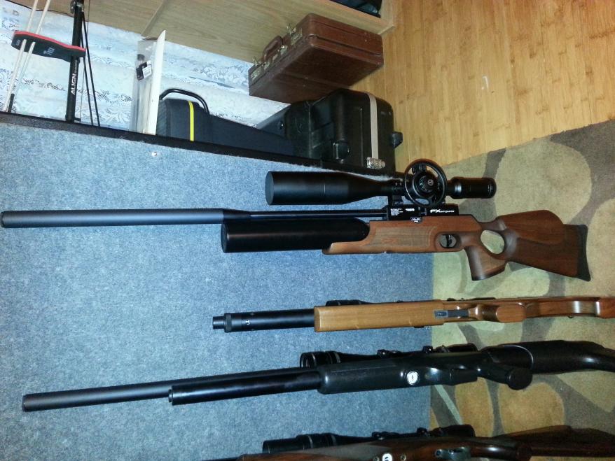

Old 07-03-2013, 05:03 AM   #5
slingarian
Join Date: Jun 2013
Posts: 2
my scope finally showed up and I put a few strings over the chronograph. here are the t
results
Name:	Boss chart64545001-878455345.jpg
ID:	54   Click image for larger version
slingarian is offline   Reply With Quote

Thanks for posting your findings. It looks like mine shoots a little hotter then yours. That may explain why your getting a few more shots then me. By the way. Some beauty's ya got there.
Dave
