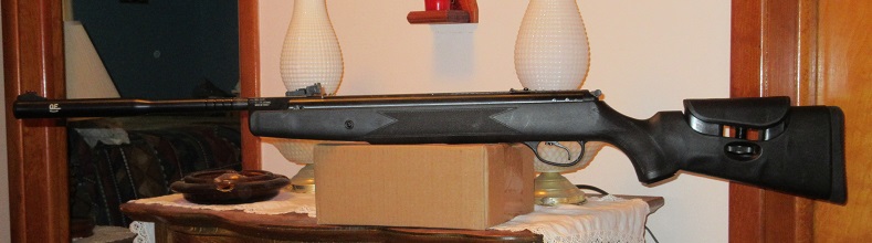

I've had the rifle awhile and it's not one most people look at, they usually go for the Model 95 because of the Turkish Walnut stock but MidwayUSA was clearancing these at the time for $118 so I figured why not. Came double boxed and actually in great shape. Rifle was in the usual Hatsan sealed bag with a light coat of oil which wipes off pretty easy.

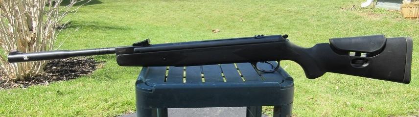

Checked everything over from end to end and only found one small scuff you'll see in the pictures which I'm not worried about. No rough spots or flashing sticking out, bluing is even and no light spots and the stock seems to be a heavier grade synthetic than they use on the Edge and Striker. There are a couple of molding spots in the stock under the riser that are noticeable, but also not something I'm worried about
The front of the shroud is actually dovetailed for the fiber optic sight which is held on with a phillips head screw so if for whatever reason you want to take it off or use a different style, it should be a pretty simple swap. The safety is also different from my other 5 Hatsans as this one after cocking you have to pull back towards you instead of pushing in to release which also might make it safer than their usual style as you can't accidently bump the safety and push it in.
The adjustable cheek riser is actually solid, not hollow like I thought it would be and the threaded stud and turn wheel are metal not plastic. It moves very smoothly compliments of that and no binding or sticky spots lik you might get with some of the guns out there that have them but use all plastic parts and being my first rifle with one will take some tinkering with. Cocking seems to be about the same as my 95 also with no hitches, glitches or grinding noises, just a nice smooth pull all the way through.

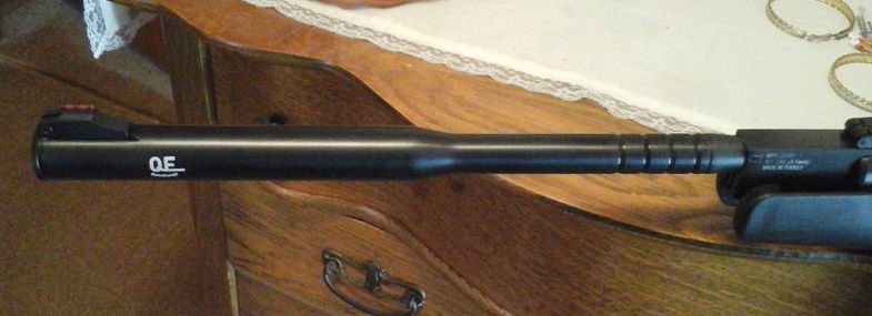

Now for the part I know everyone is wondering about...the QE shrouded barrel. It's actually a little quieter than my Mod 95, but that's tempered by parts of the stock being hollow, so you get some ringing in the stock when shooting so while the shrouded barrel may make for a quieter firing pellet, it doesn't quiet the piston noise and ringing and something I'll probably also tinker with to see if I can deaden it like I did with my Edges.
ID:	99   Click image for larger version
ID:	100   Click image for larger version
Name:	87QE Barrel.jpg
