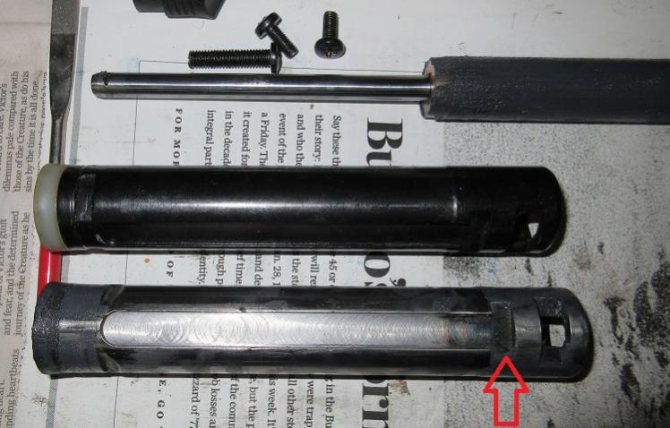

There is a difference between the older and newer rifles and it's in the piston. In the pic of the pistons below, the top black one is the new Hatsan piston and the lower silver one is the VMX. The width of the slot the red arrow is pointing at is the difference in the length of them. There's also no hole drilled inside the piston for the end of the gas ram arm, so between that and the extra length of the piston, it was causing the rifle not to cock.
It wasn't quite as simple as just dropping in the Hatsan gas ram, you'll also have to use the Hatsan piston, but the rifle is back together and shoots very nicely. Smooth cocking and shot cycle, no real difference in recoil and because I also took JSB's and FTT's outside with the chrony, it also has more power.
